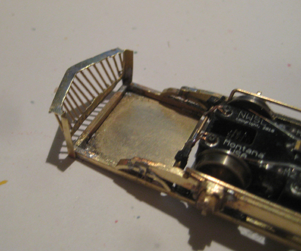

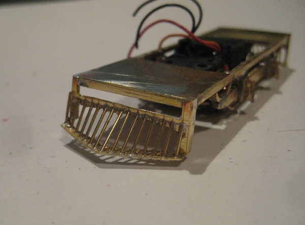

So I got more bench time than I thought I might ......... got the pilots mounted to the sub frame.
I have a resistance soldering rig so some of this goes really fast.  I use a liquid flux for everything which makes the solder flow go more quickly.  Often a solder will go off but the rosin core has not gotten hot enough yet.  The flux makes it go off at much lower temps.
There some diagonal supports that show in the prototype photos that will have to go on and there is is s TON of clean up left to go....  The super structure is next.
Thanx for looking in..........

What a great job . Just curious though , couldn't you have glued the castings Bob ?

I suppose I could have glued the cast pilots on but the metal is soft and probably would have been pretty fragile.   Besides...............  I was pretty sure from the out set that I would have to make them up.
They aren't that tough...  Looks tougher than it really is.  It's all about getting the lay out right and square first.  After that you can't miss.
They really are rather fun to make up.  At the end of the day you can tell yourself that you really did something.

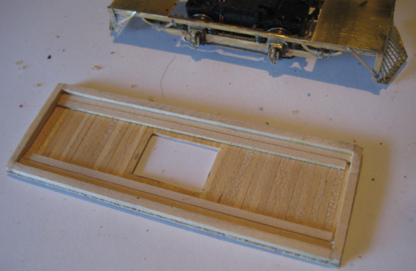

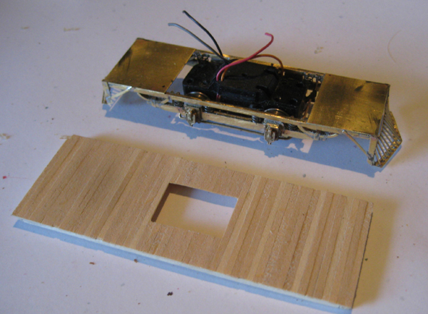

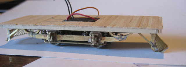

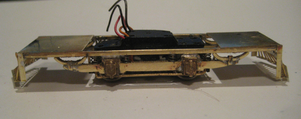

I got some bench time and made up the main deck.  The cutout is due to a raised area in the power truck and also place to get the wires to the decoder.  I am keeping the cut out close so the wiring and electronics are not visible from the bottom.
 I have yet to scale out the superstructure but that will happen yet today or tomorrow.
I will run a single screw up through the sheet brass area at each end and grab the bottom of the superstructure in the center line of the car.

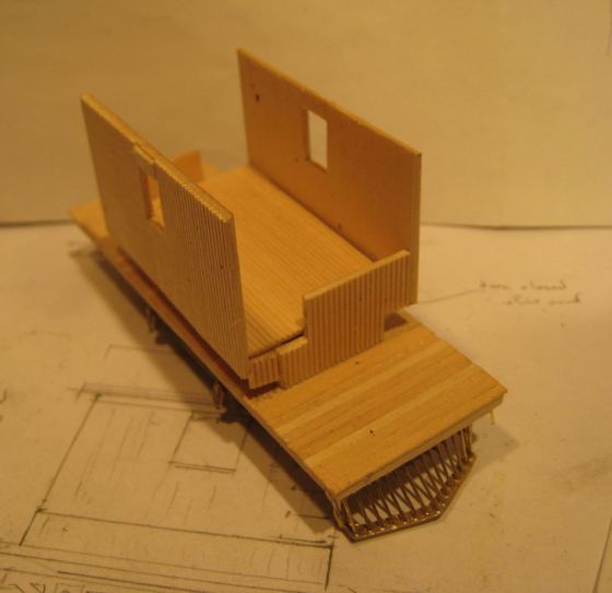

So progress has slowed a bit..... glue times with wood are MUCH slower that soldering with a resistance rig.  As soon as it cools and you can handle it you move on.  Not with wood and glue.  Some stuff goes pretty quickly when pressed together but the core framing needs overnight to really kick off the glue.

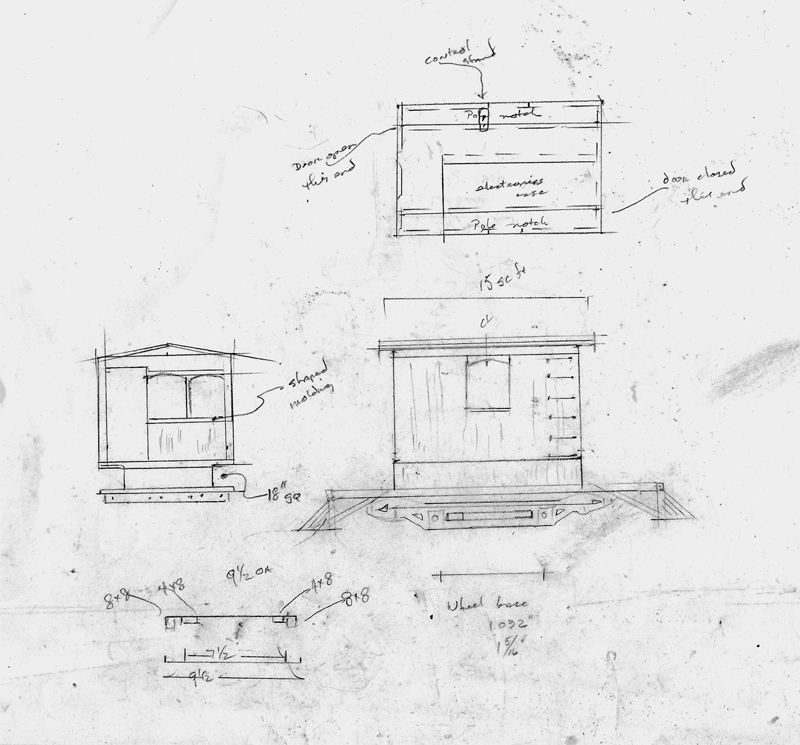

So here is the plan.  Now John Siekirk will get after me for this as he is educated as an engineer and designer.  My engineering is a bit more seat of pants as I worked for Mercedes Benz and Volvo and only went after their designs when they didn't work in the wild and woolly west.  I got called back to the engineering labs in New Jersey a lot in the late 70's to mid 80's.
I had a frame plan from the outset but the superstructure was later in coming.  Well I need it now so I made it up from the best of the photos that I currently have.
I think I have in this plan a way to make the end door to operate.  It was on a sliding track and I think I can do that with a wire on the top of the door and a brass micro tube as a guide receptacle.   Also I will have the roof removable for a complete interior.

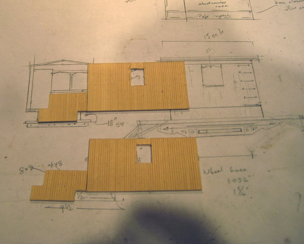

Here then is an initial layout on the plan for the side and end walls.  This is all the more of a plan that I need to build this.  I use a combination of scale rulers and metric rulers.  I find fractional rulers to not be precise enough and also you cannot add up lengths and distances easily.  Metric allows you to count up from one..... nothing changes when you get to those things called inches ! ! !
Here is a photo of a panel layout. You can see why my plans get dirt and smudges on them.  I only think to make a photo copy of them later when they are already dirty.
More later.

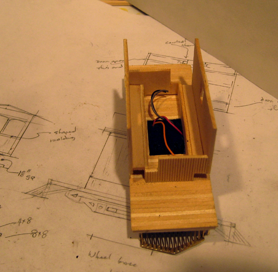

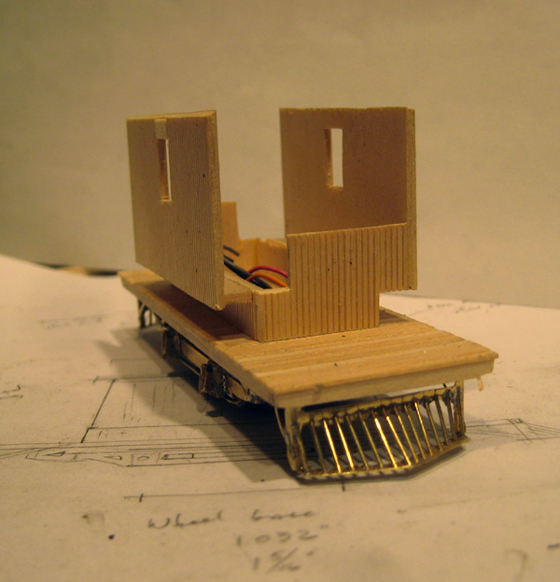

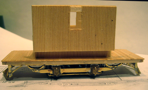

I got in about four glue sets after the initial ones last night.  Here is the basic superstructure.
The layouts allowed for the door and window inserts on each end.  I'll build the window casements from various strip wood.
