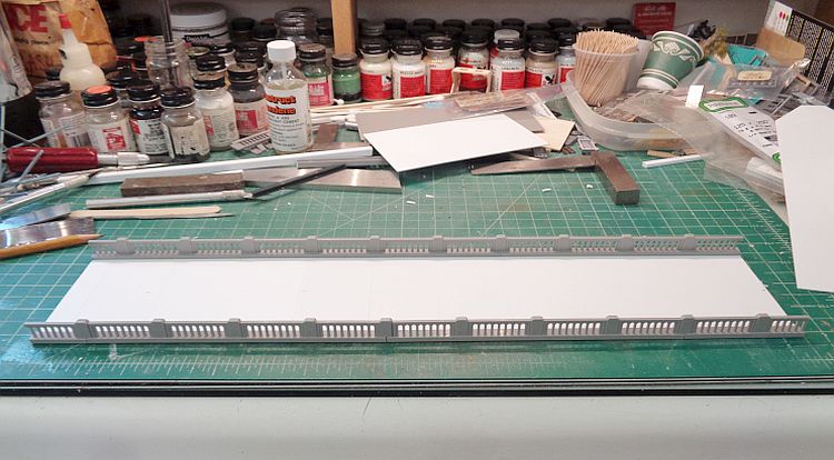

I cut a section of polystyrene the width of the road and wide enough this time to allow for the pillars.
It will fit on the inside edges of the bridge as shown below. The base of the pillars, when installed, will fit onto the white polystyrene strips I glued to the inside of the bridge sides.

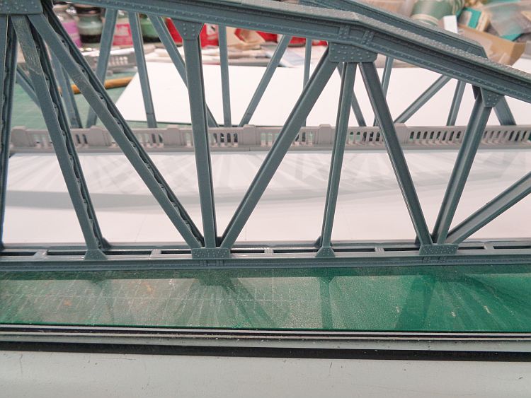

I then measured carefully or carefully measured, maybe both, the width I needed the bridge to be. I did this several times and constantly checked to make sure I got it right.
When satisfied, I then cut some scale 12 X 12s for the bridge frame base. I started in the middle and then each end. Although I made sure the bridge was square, I found as the glue dried, the bridge became unsquare by 1/32".
I found this out when I test fit the roadway base on the inside of the bridge.
I fixed this by clamping a metal square to the bridge and gluing in a 12 X 12 on each end.

I then glued the pillars to each side. I made sure they were up against the styrene sheet as I glued the in place. As this section is going on the bridge base, I didn't need to glue the wedges to the side and under each large pillar.

The roadway now slides or just drops onto the bridge as shown.
I designed it this way for painting purposes. The bridge will be painted silver and the roadway section concrete. A bit to difficult to paint the two with them glued together.

Here is how the first two sections of the bridge looks in place. They are just sitting on what I could find to hold them up.
