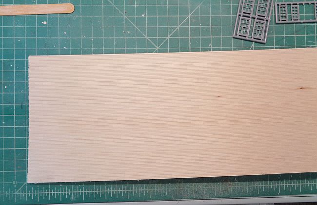

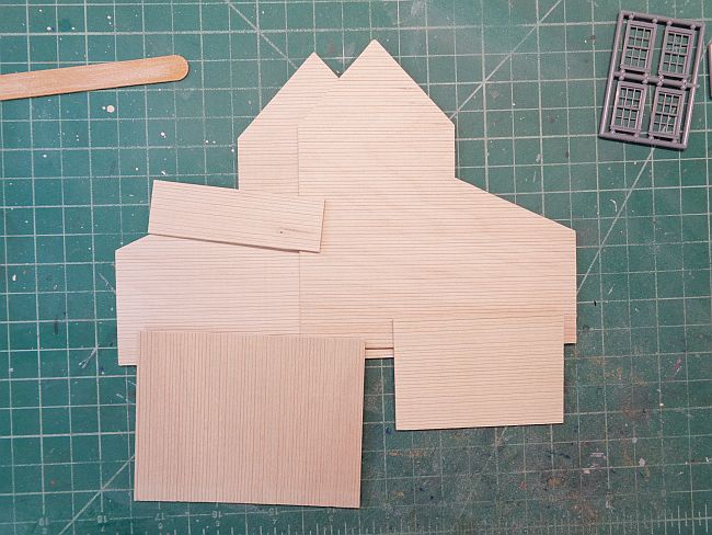

Prior to sending Eric Fox Run, I copied the walls in word on a 1:1 copy. I then printed the pages and cut out the walls. I marked the walls on the rear of Northeastern Lumber siding. I marked where George had his windows and doors.
As mentioned earlier, I have no FSM door or window casting. I'll use what plastic windows and doors I have on hand. I'll place them close to where they are on the FSM kit.
I neglected to take photos of any of the above mentioned steps but I do have some still marked on the back of the lumber. More on this later.
I started with this -
And ended up with this, the main walls of the build.

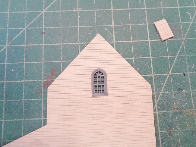

I marked and then cut out a portion of the upper most window on the main wall.
I rounded the top for a proper fit.
Continued -
This is Tichy window #8047.

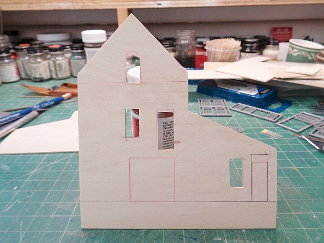

I then began to cut out other window and doors. In the next photo you can see where the original openings are located, marked in red.
Continued -
